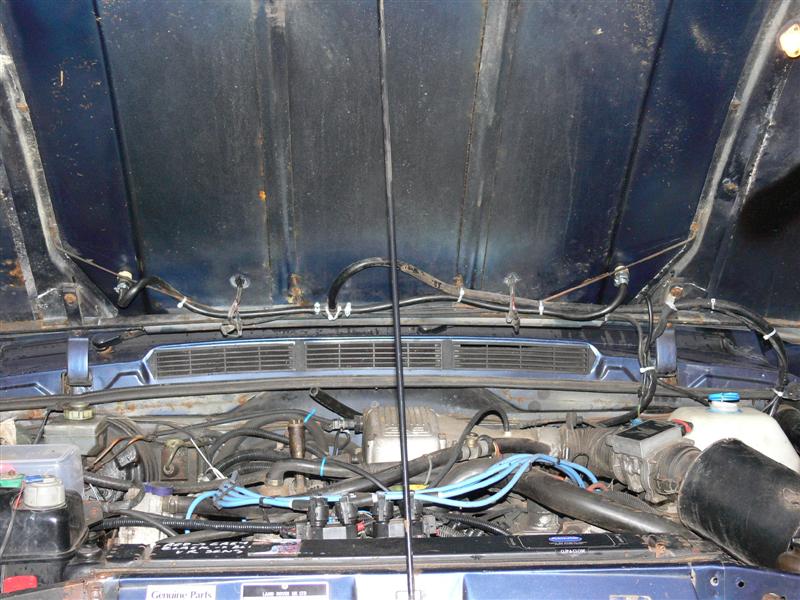

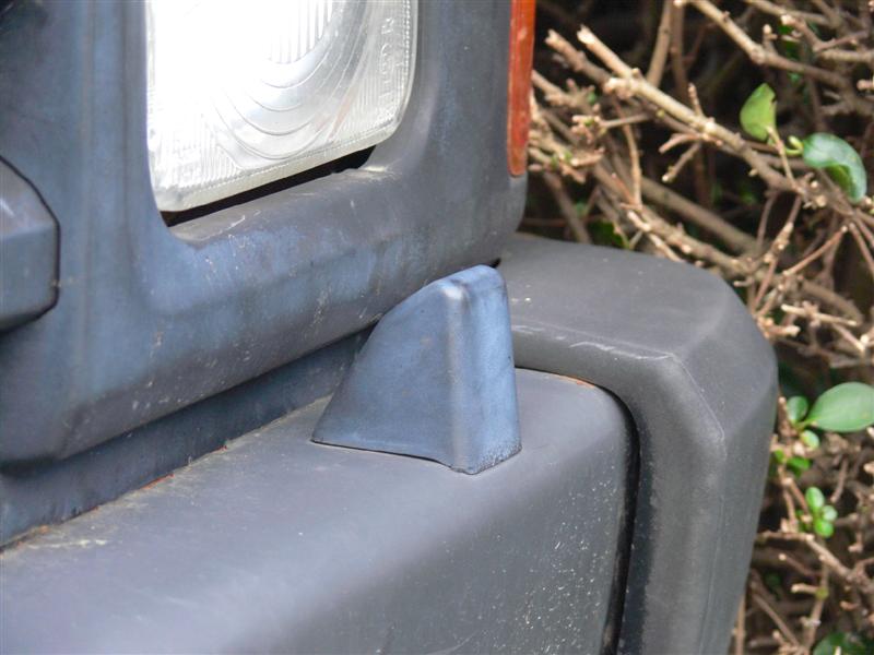

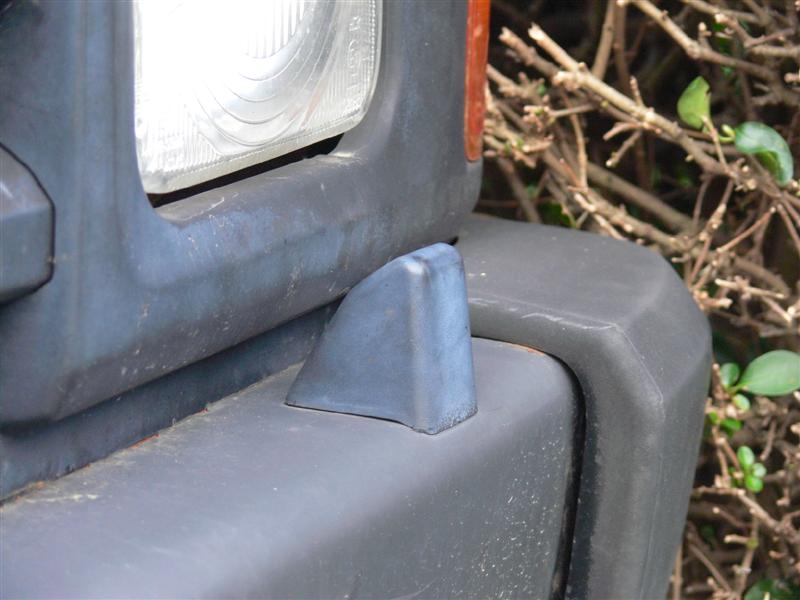

First - the existing setup on the Disco bumper:

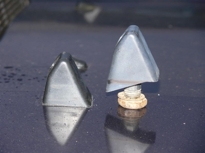

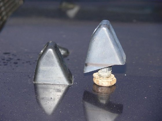

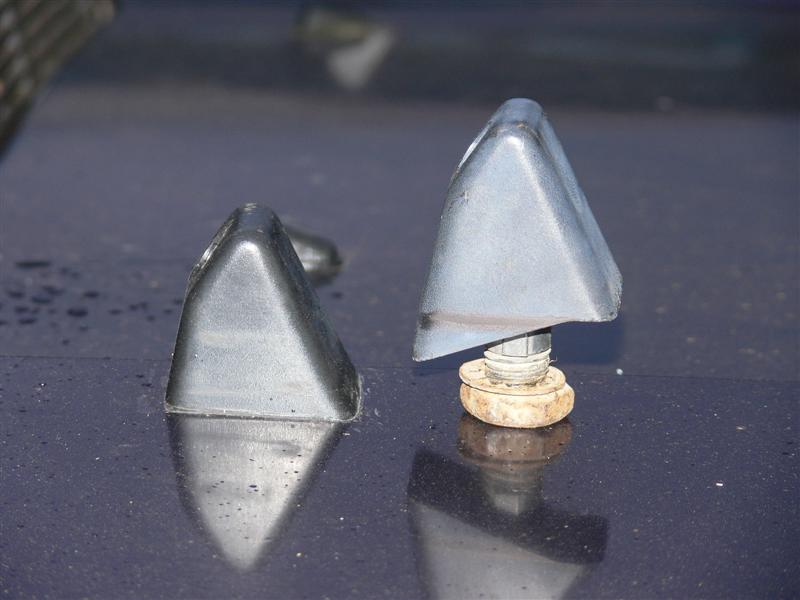

They were cut along the line to make them sit at a better angle:
They were plumbed in using a mix of original pipe and some leftover petrol pipe:

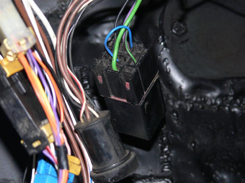

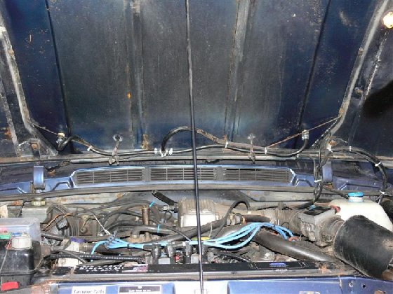

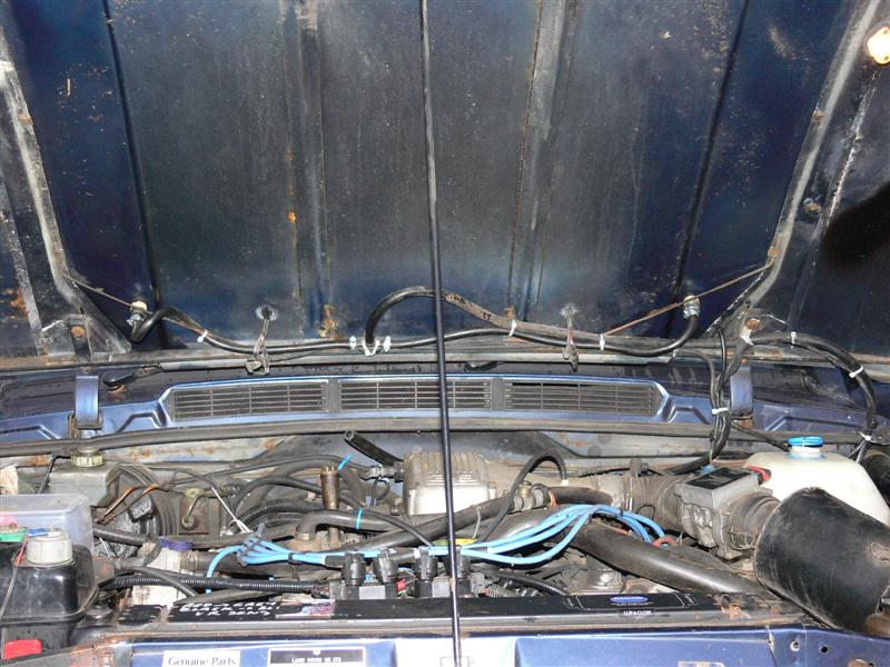

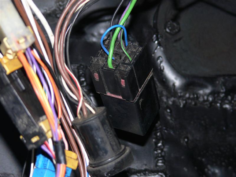

The original relay was used (which limits the super-soakers to a one second blast), but was wired in so that it doesn't need the headlights to be on to work - see the blue wire linking back to the live feed - I now intend to wire this into a switched feed

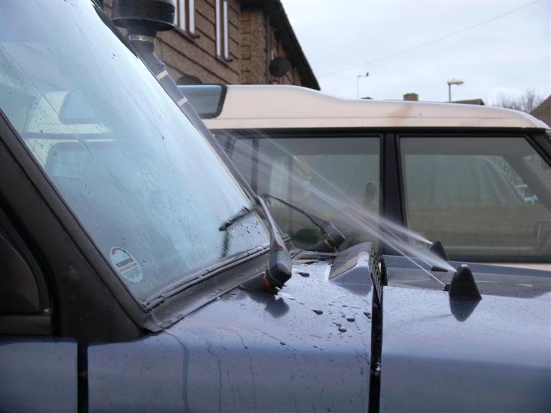

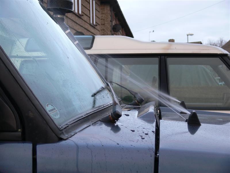

Here they are in action:
