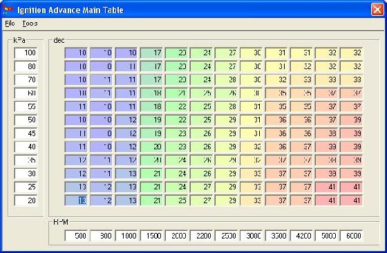

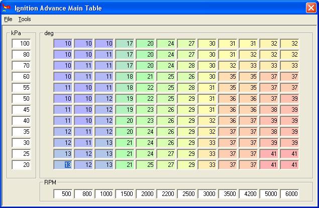

This is a screen grab of the ignition map I've used on the last couple I've done.
I've also attached a .vex file containing the data, not sure if you can use that ?

Now THAT looks more like it - although I think I'll knock the 6000rpm bucket down to zeros to create a rev limiter zone - I don't think my motor would be up for 6000rpm...
I'll try that this evening.
Cheers
Roger
edited to add:
Well I now have your map on my MJ and it's certainly a vast improvement on anything I have tried so far
Thanks!
I had to make some mods since MJ only has a 10x10 map, and I also smoothed out some of the lumps and dips which I assume are for a specific engine requirements, but it's a lovely map compared to most I have seen.
The immediately noticeable difference is the pickup off idle which is much sharper and tolerant of stupidly quick throttle movements than before. I also managed to lean it off a load - unfortunately now that I have done that I can see that it burns oil
Hopefully not enough to fail the MoT though...
