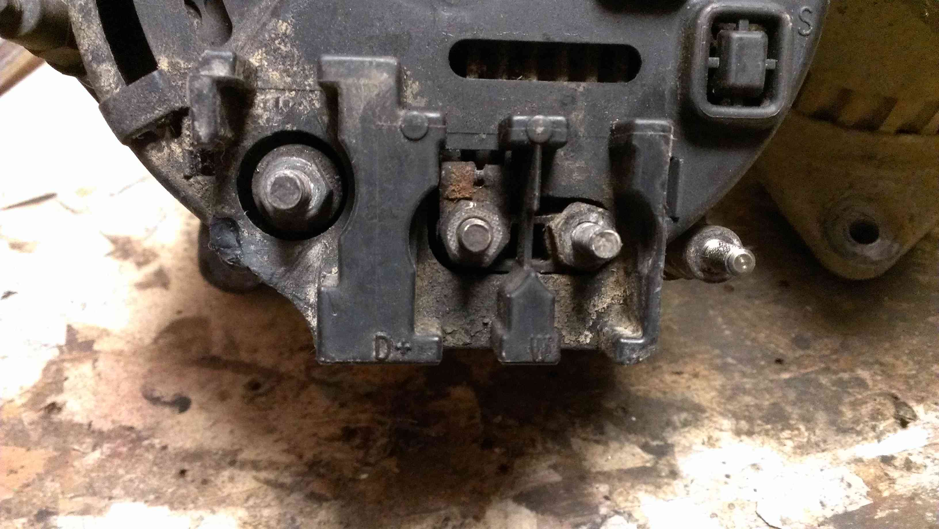

Got this one sorted now. It involved un-soldering the connections to the stator so I could get it apart and then re-soldering them. Took a fair bit of heating the casing and tapping it to get the stator out though. Don't fancy trying that again on an old one, but you can get new ones for about £80 so I'll probably do that and hope the stator moves easily.
The wiring to the back seems to be 3 ring terminals. From the Haynes it looks like only 2 of them are needed.
The right hand two seem to be labelled D+, and W. The leftmost doesn't have a letter on this alt (that I can see)
My old 45 amp alt has 3 spade terminals. Two large ones which both go to the starter and the third for the indicator wire.
Any ideas which way I'd connect them up?
